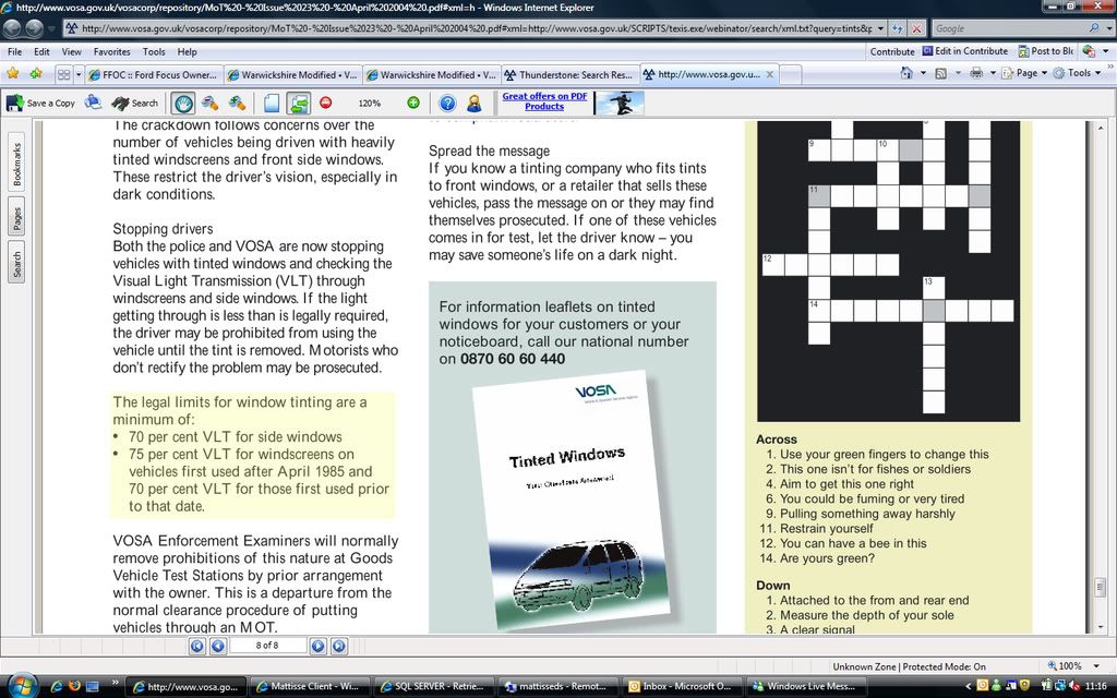

18 years 2 months ago #2983 by slacker
Replied by slacker on topic Law On Window Tints

oooo i might ask for the booklet to be sent to my door, that way ill keep it in the glove box, and if mr police man says they are illegal, ill whip out my booklet (VOSA laws) and show him who's wrong :D
