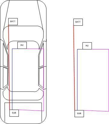

Ok here we go, a nice simple diagram
Key:
Red = Live
Blue = Remote
Pink = Signal
1.Live Wire
Key:
Red = Live
Blue = Remote
Pink = Signal
1.Live Wire
