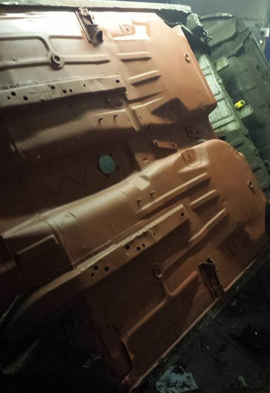

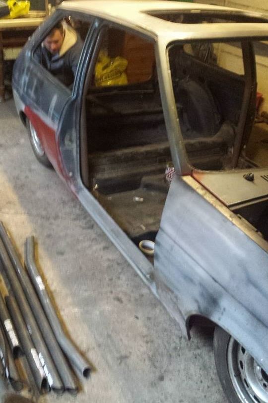

The first stage was getting the shell on a roll over spit. and cleaning 31years of crap off it.
after a long session with the grinder and zipwheel and alot of swearing

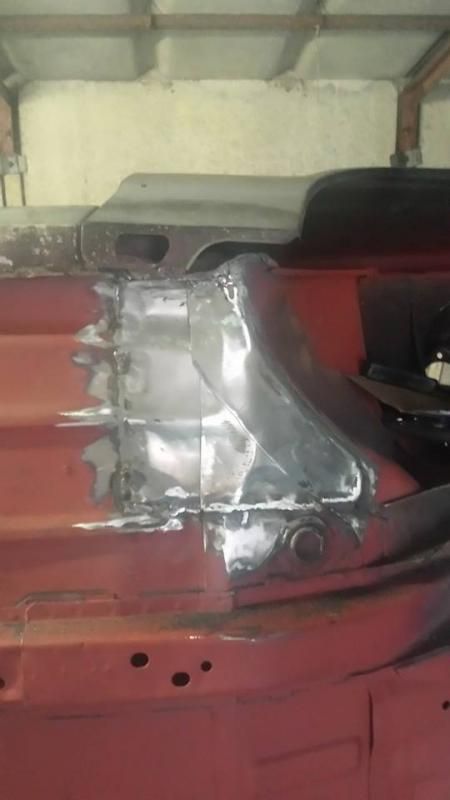

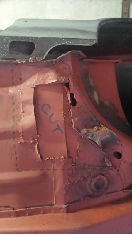

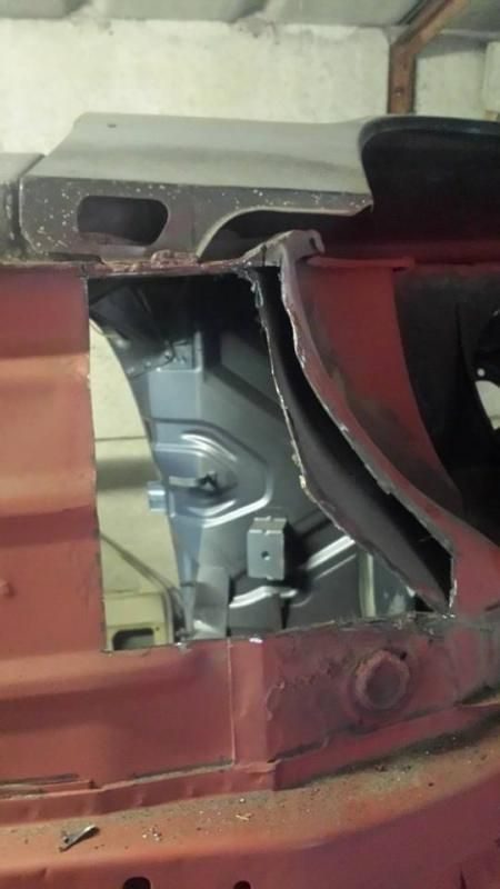

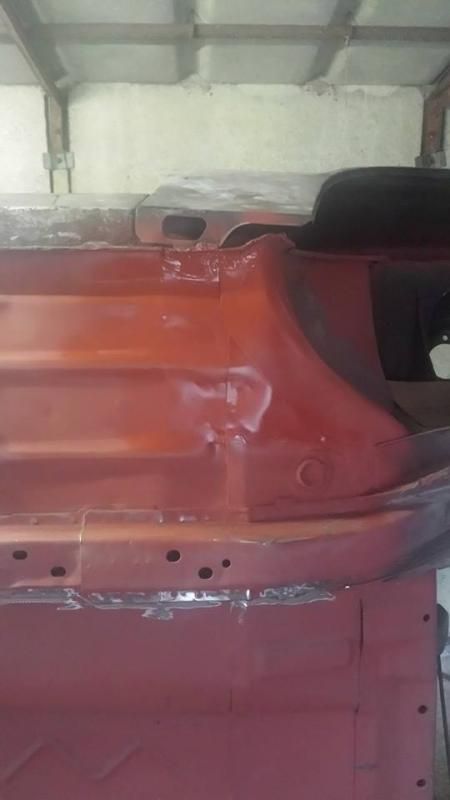

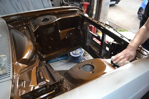

Once the bulk was cleaned old crappy repairs that looked good from the inside turned out to be shultz covered bodges no surprise there haha but it is the only real rot on a fiesta which is remarkable.

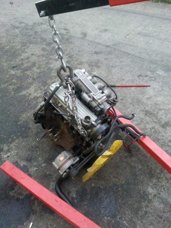

out with the old
mid repair
Done
now its not perfect but if people can see it ive done something wrong haha.

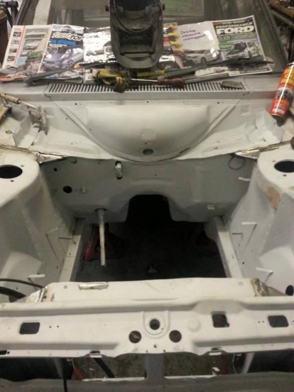

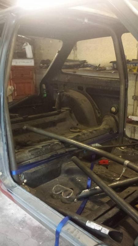

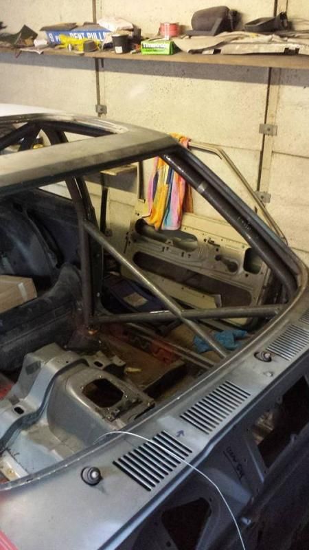

with the floor tidy the next step was to brace the shell ready for the floor being chopped out.
How low can you go? haha
so that was the basic cage tacked into the position, the last pics give away whats coming next. usually i would just bend up a tunnel but seeing as the centre diffs in the middle of a cossy box it would take a bit to cut weld and shape it all then mount etc. so i just went and chopped a tunnel out a xr4x4.

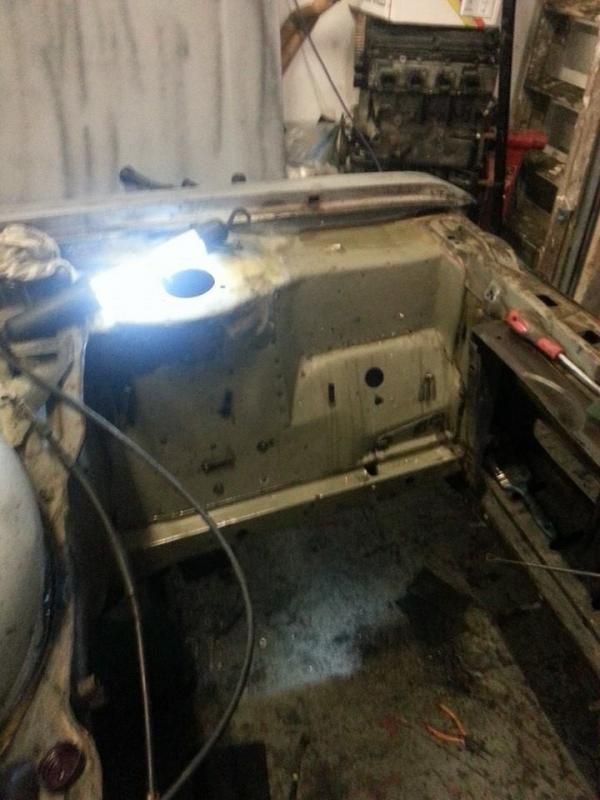

Now the tunnel currently was very wide, so wide infact it went past the chassis rails of the fiesta, 4 1mm cutting discs later and a lot of measuring we have this.
the keen eyed will notice that this is upside down <!-- s:lol: --><img src="{SMILIES_PATH}/icon_lol.gif" alt=":lol:" title="Laughing" /><!-- s:lol: -->
and thats it for now.

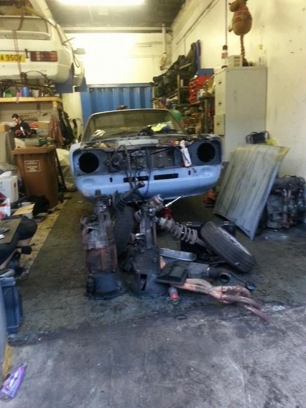

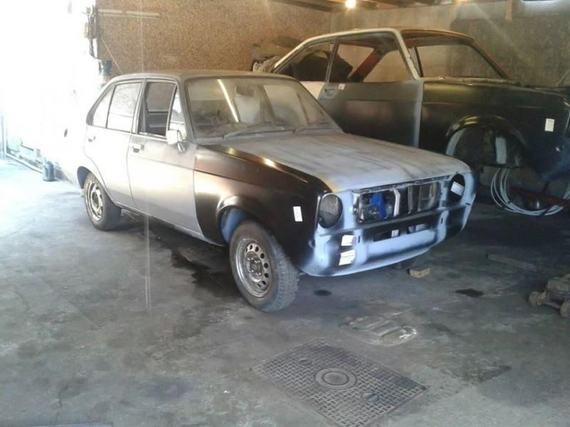

Heres my old daily mk2 escort more door resto, it was a 1300gl but its now running a rebuilt 2.0 efi pinto with high torque cam and a few other goodies, its been strengthened and gusseted, panhard rod tramp bars, LSD, and has a host of other parts to be fitted when i get round to it such as Coilovers, quickrack, 2 inch lowering blocks, decambered springs alsorts <!-- s:lol: --><img src="{SMILIES_PATH}/icon_lol.gif" alt=":lol:" title="Laughing" /><!-- s:lol: --> its had all sorts replaced on it to make it mint but it has came to a standstill since moving down here along with the rest of my projects back home.
mid rebuild
